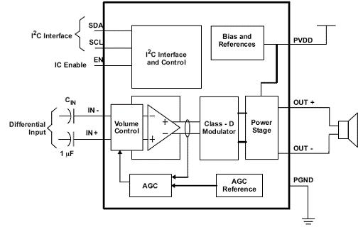

图1.TPA2028D1功能方框图

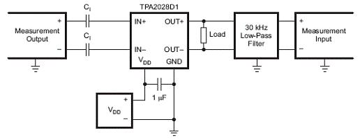

图2.TPA2028D1指标测试方框图

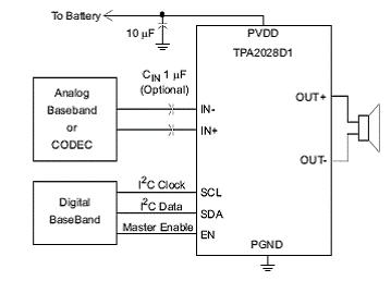

图3.TPA2028D1简化应用方框图

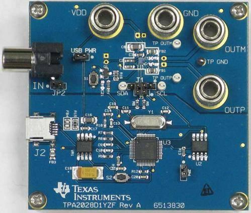

TPA2028D1YZFEVM评估板
The TPA2028D1 evaluation module (EVM) is a complete, stand-alone audio board. It contains the TPA2028D1 WCSP (YZF) Class-D audio power amplifier.
TPA2028D1YZFEVM评估板指标:
图4.TPA2028D1YZFEVM评估板外形图

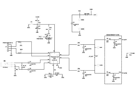

图5.TPA2028D1YZFEVM评估板电路图(1)

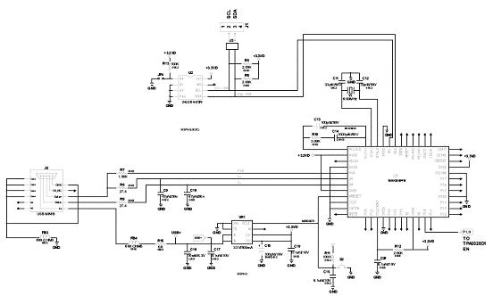

图6.TPA2028D1YZFEVM评估板电路图(2)

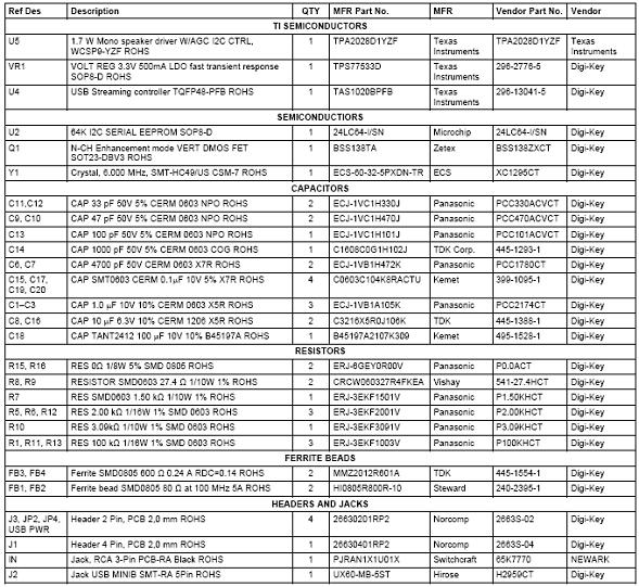

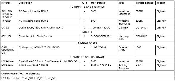

TPA2028D1YZFEVM评估板材料清单(BOM):
