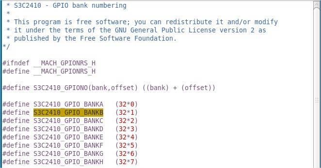

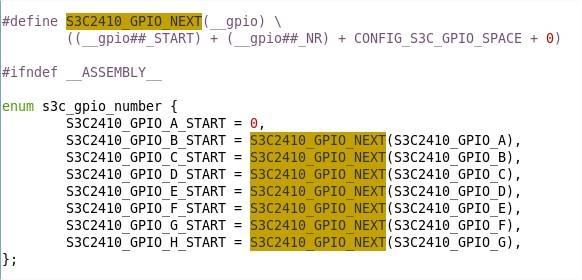

S3C2410_GPIO_BANKB-->
此宏的定义是在/linux-2.6.32.2/arch/arm/mach-s3c2410/include/mach/gpio-nrs.h中定义.

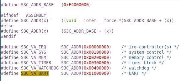

S3C24XX_VA_UART在linux-2.6.32.2/arch/arm/plat-s3c24xx/include/plat/map.h中这样定义:
而S3C_VA_UART在linux-2.6.32.2/arch/arm/plat-s3c/include/plat/map.h中这样定义:
由以上宏定义可以推出:
S3C24XX_VA_GPIO=((S3C24XX_PA_GPIO - S3C24XX_PA_UART) + S3C24XX_VA_UART)
               =((0x56000000 - 0x50000000) + (0xF4000000 + 0x01000000))
               = (0x06000000 + 0xF5000000)
               = (0xFB000000)

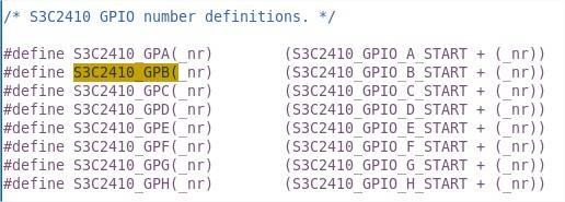

这里假设设置GPB5引脚为输出:
s3c2410_gpio_cfgpin(S3C2410_GPB(5),S3C2410_GPB_OUTPUT);
首先S3C2410_GPB(_nr)在/linux-2.6.32.2/arch/arm/mach-s3c2410/include/mach/gpio-nrs.h中这样定义:
