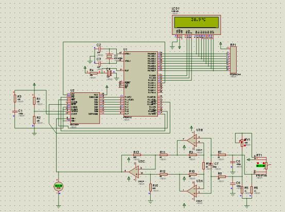

pt100测温程序-LCD1602

#include"at89X52.h"
sbitLCD_RS=P2^0;
sbitLCD_RW=P2^1;
sbitLCD_E=P2^2;
sbitADC_CS=P2^3;
sbitADC_WR=P3^6;
sbitADC_RD=P3^7;
#defineLCD_DATAP0
unsignedcharLcdBuf1[10]="";
unsignedcharcodeBmp001[][8]=
{0x06,0x09,0x09,0x06,0x00,0x00,0x00,0x00},
{0x06,0x09,0x10,0x10,0x10,0x09,0x06,0x00}
voiddellay(unsignedinth)
while(h--);//0.01MS
voidWriteDataLcd(unsignedcharwdata)
LCD_DATA=wdata;
LCD_RS=1;
LCD_RW=0;
LCD_E=0;
dellay(1000);
LCD_E=1;
voidWriteCommandLcd(unsignedcharwdata)
LCD_DATA=wdata;
LCD_RS=0;
LCD_RW=0;
LCD_E=0;
dellay(1000);
LCD_E=1;
voidlcd_init(void)
LCD_DATA=0;
WriteCommandLcd(0x38);
dellay(1000);
dellay(1000);
WriteCommandLcd(0x01);
WriteCommandLcd(0x0c);
voiddisplay_xy(unsignedcharx,unsignedchary)
if(y==1)
x+=0x40;
x+=0x80;
WriteCommandLcd(x);
voiddisplay_string(unsignedcharx,unsignedchary,unsignedchar*s)
display_xy(x,y);
while(*s)
WriteDataLcd(*s);
s++;
voidWrite_CGRAM(unsignedcharadd,unsignedchar*char_num)
unsignedi;
add=add<<3;
WriteCommandLcd(0x40|add+8);
for(i=0;i<8;i++)
WriteDataLcd(*char_num++);
voiddelayms()
inti;
for(i=110;i>0;i--);
voiddelay1s()
inti,j;
for(i=1000;i>0;i--);
for(j=110;j>0;j--);
voidconvert()
unsignedlongvalue;
chari;
unsignedlongres;
inttemp,temp2;
intw;
P1=0xff;
ADC_RD=0;
for(i=0;i<10;i++);
value=P1;
res=(float)(2550000+110000*value/30)/(2550-11*value/30);
temp=(float)(res*10000-10000000)/3851-545;
temp2=temp;
if(temp>=0)
for(i=6;temp>0;i--)
LcdBuf1[i]=temp%10+48;
temp/=10;
if(temp<0)
w=-temp;
for(i=6;w>0;i--)
LcdBuf1[i]=w%10+48;
w/=10;
if(i>=0&&temp<0)
if(temp>-10)
LcdBuf1[i]=0;
i--;
LcdBuf1[i]=-;
i--;
/* if(i==5)
LcdBuf1[5]=0;
i--;
LcdBuf1[4]=-;
i--; */
for(;i>=0;i--)
LcdBuf1[i]=;
for(i=0;i<5;i++)
LcdBuf1[i]=LcdBuf1[i+1];
if(LcdBuf1[4]==)LcdBuf1[4]=0;
LcdBuf1[5]=.;
LcdBuf1[7]=1;
LcdBuf1[8]=C;
WriteCommandLcd(0x84);
display_string(3,0,LcdBuf1);
ADC_RD=1;
ADC_WR=0;
for(i=0;i<10;i++)
ADC_WR=1;
delayms();
main()
unsignedchari;
lcd_init();
for(i=0;i<2;i++)
Write_CGRAM(i,Bmp001[i]);
ADC_CS=0;
ADC_WR=0;
for(i=0;i<10;i++);
ADC_WR=1;
while(1)
convert();
delay1s();
