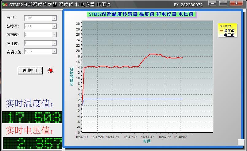

做了个上位机

//ADC内置温度传感器使能(要使用片内温度传感器,切忌要开启它)
ADC_TempSensorVrefintCmd(ENABLE);
//常规转换序列1:通道10
ADC_RegularChannelConfig(ADC1, ADC_Channel_10, 1, ADC_SampleTime_13Cycles5);
//常规转换序列2:通道16(内部温度传感器),采样时间>2.2us,(239cycles)
ADC_RegularChannelConfig(ADC1, ADC_Channel_16, 2, ADC_SampleTime_239Cycles5);
